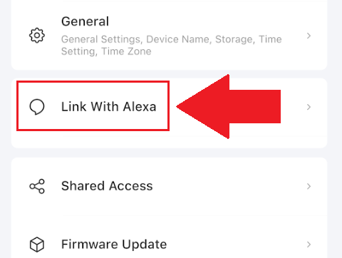

Step 2: Open the AMLINK Pro app and access your device. Access device settings and scroll down until you see Link With Alexa. Tap Link With Alexa to proceed.

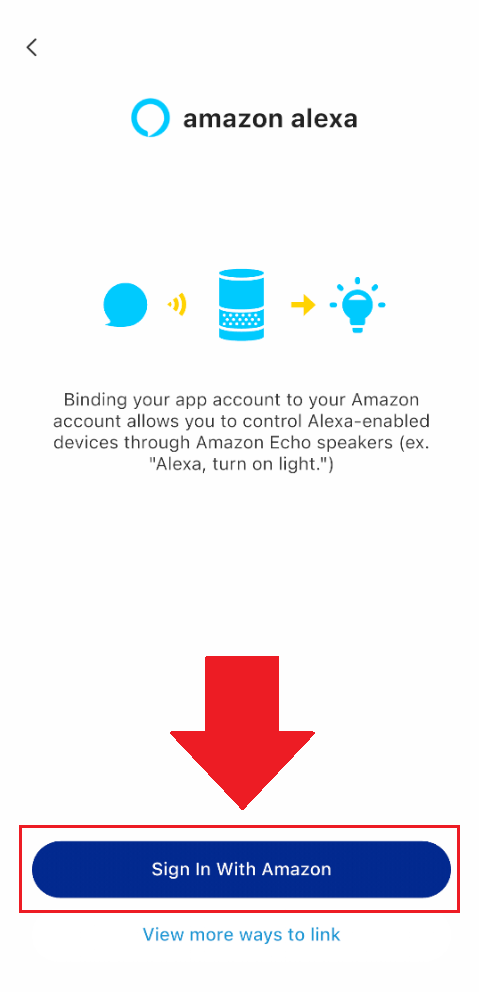

Step 3: Tap Sign In With Amazon.

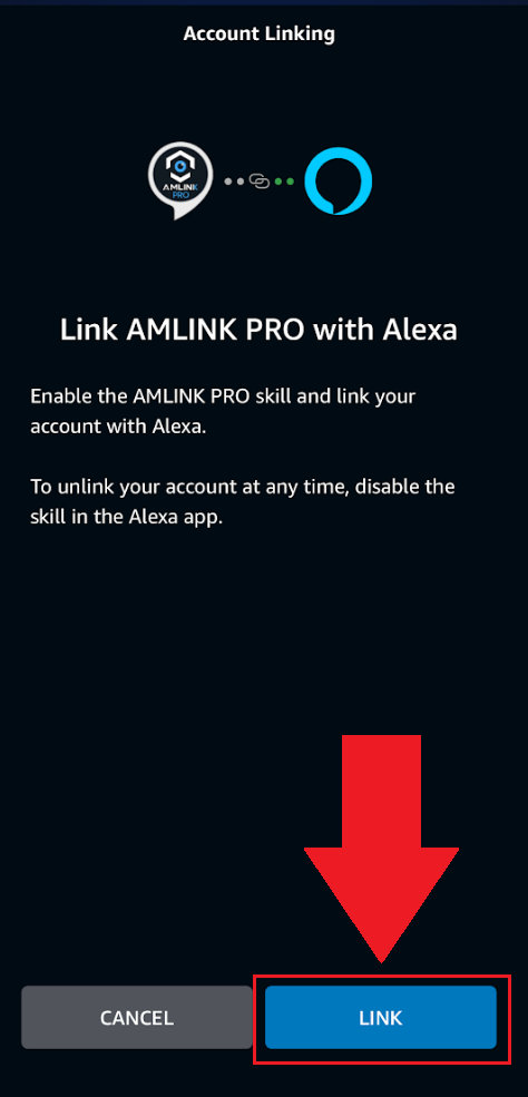

Step 4: Tap Link. This will like your AMLINK Pro app with Alexa.
After linking your AMLINK Pro app to Alexa the device will not be linked to your Amazon Alexa.
