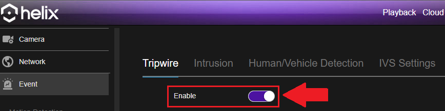

Step 2: Click on Settings>>Event>>IVS>>Tripwire and click Enable.

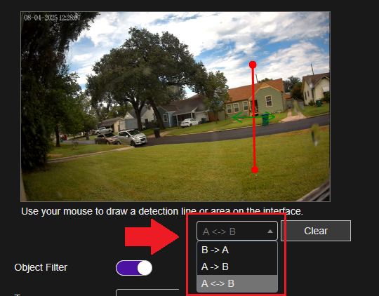

Step 3: Use your mouse to draw a tripwire detection line on the interface. Use the directional dropdown menu to set which direction the object will be going for the tripwire to be triggered. It can be set left, right, or in both directions (A<->B). Click the Clear option to remove the detection line.
Step 4: The feature will be set to trigger if a human or vehicle crosses the detection line, however, the rule can be set to human only or vehicle detection only. Use the Type dropdown menu to modify the object filter if needed.
