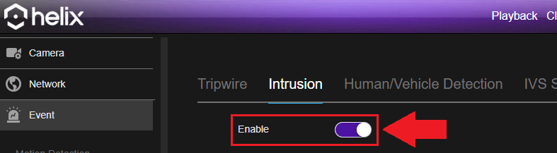

Step 2: Click on Settings>>Event>>IVS>>Intrusion and click Enable.

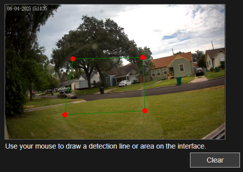

Step 3: Use your mouse to draw a detection area on the interface. By default, the detection area will be set to full screen, however, to adjust the area use your mouse to set a customized detection area. Click Apply. Click the Clear option to remove the detection line.
