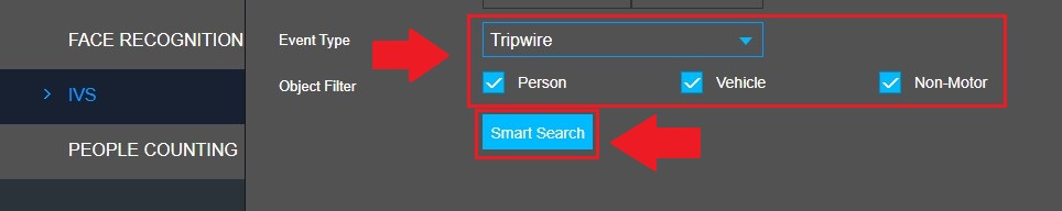

Viewing IVS Events
Any IVS data retained on the system can be viewed using the IVS Smart Search interface or via the playback menu if an IVS schedule is set in the system.
To view IVS data using the IVS smart search interface, click on the IVS option located in the Smart Search menu. Enter a start and end time of the event and click Search.
A layout of all IVS events captured by the device will be displayed. To view the event, select the event from the interface and click the play button. To filter only specific objects in the smart search menu, select the Event Type from the dropdown menu, select which object filter you would like to view and click Smart Search.
