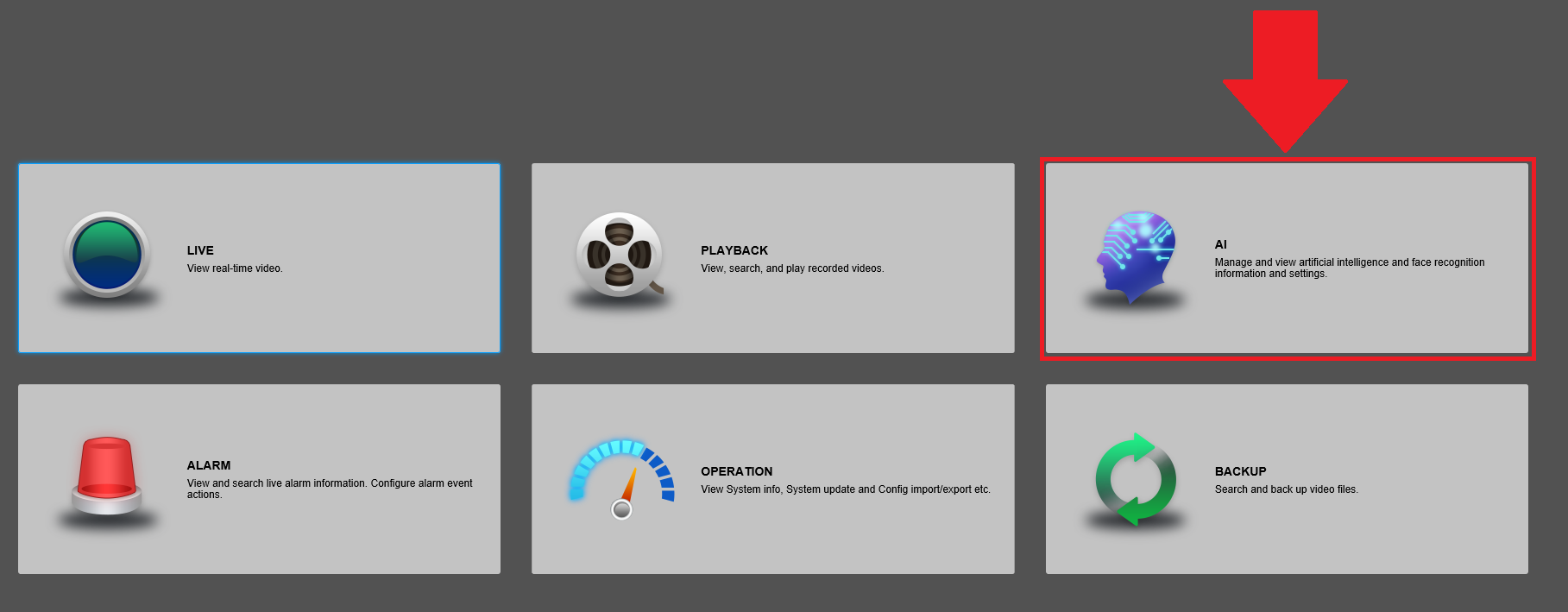

Step 2: On the main menu, click on AI.
Note: A Smart Plan may not be available if using AI features with a non-AI camera. This is normal if using a non-AI camera on an AI NVR.

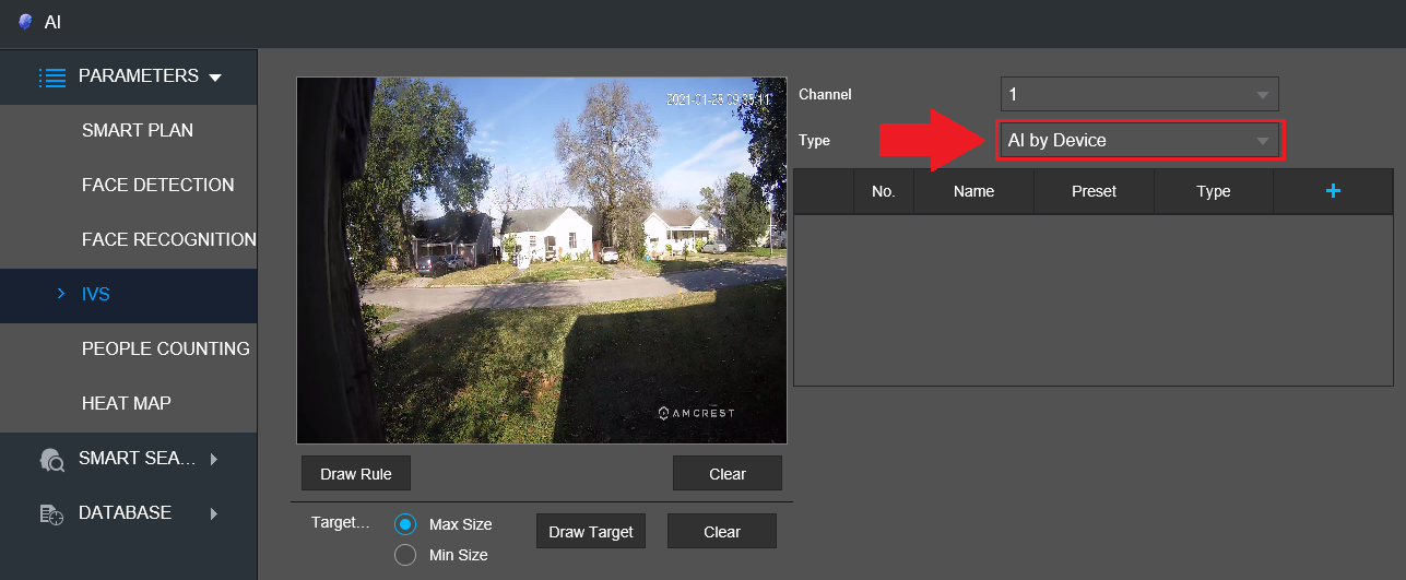

Step 3: In the Parameters section, select which AI feature you would like to apply to the camera. In this example, we will be using IVS but the same concept can apply to other features. In the Type section, you will notice the rules are being applied to AI by Device which indicates the rules are being controlled by the NVR's built-in AI functions.
From this point, you can not begin applying the rules to your camera. For more information on how to set up IVS, AI rules, or other useful information regarding your AI NVR, please click here.
