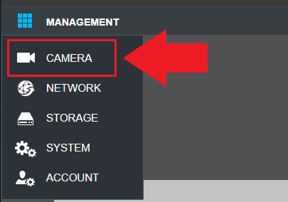

Step 2: Select Management and click Camera to access the camera registration page.

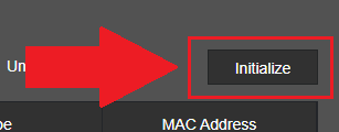

Step 3: Click Device Search to locate your camera. If the status is registering as an "X" that means it has not been initialized. To initialize it, select the camera and

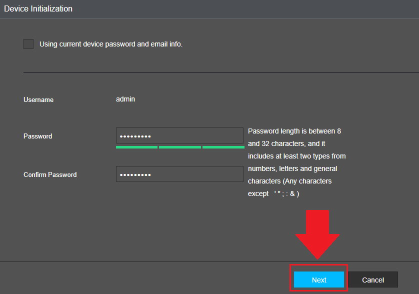

Step 4: If you would like to use the same password and email information associated with your NVR for your camera you can leave the "Using current device password and email info." option enabled. However, if you would like a separate credentials for your camera, the option can be disabled. Enter and confirm the password you would like for the camera and click Next.
Enter the email address as well in the next field and click Next (this part can be skipped as well if needed).

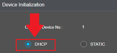

Step 5: Select DHCP for device registration. Click Next to continue.

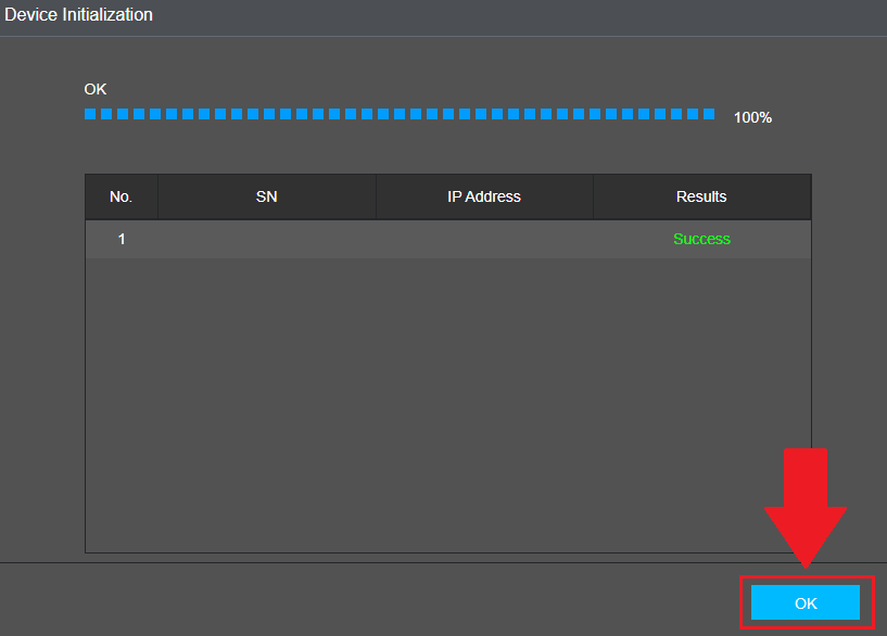

Step 6: Allow the device to be initialized. Once it has finished, click OK.

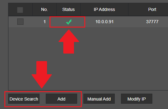

Step 7: Click Device Search, you will notice the status of your camera will have a green checkmark indicating it is ready to be added to the NVR. Select Add and import it into the NVR.

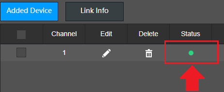

Step 8: The status will be red indicating the device password will need to be modified within the NVR. Click the Edit icon for your camera, enter the camera's password, and click Save. Select the device and click Refresh, the status will change to green (if the password is entered correctly) indicating it is good to go and initialized within the NVR.
