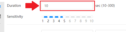

By default the rule will be set to trigger if multiple people are within the detection area for a duration of 10 seconds. However, you can adjust the duration if needed from 6 - 300 seconds. Use the sensitivity slider to adjust the amount of people detected before the rule is triggered. The higher the sensitivity the less people are needed in the area before it is triggered.
