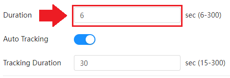

Step 6: Click Add Rule and select Parking Detection from the dropdown menu. Use your mouse to draw a detection area on the interface.
By default the rule will be set to trigger if an object is within the detection area for a duration of 6 seconds. However, you can adjust the duration if needed from 6 - 300 seconds.
Note: This camera also supports Auto Tracking. This will allow the camera to automatically track the object until it is no longer visible in the detection area or for a duration of 15-300 seconds.
