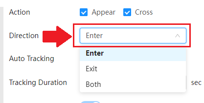

Step 7: Click Add Rule and select Intrusion from the dropdown menu. Use your mouse to draw a detection area on the interface. Please note, an option effective target filter can be set that will allow the rule only to trigger when a human or vehicle crosses the line.
The rule can be set to trigger an event if an object appears or crosses the detection area. If Cross is selected, you can choose to trigger the rule if a object enters only, exits only, or both.
