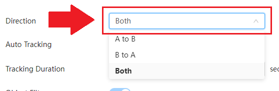

Step 7: Click Add Rule and select Tripwire from the dropdown menu. Use your mouse to draw a detection line on the interface. Please note, an option effective target filter can be set that will allow the rule only to trigger when a human or vehicle crosses the line.
The detection line can be set to detect object from different directions, A to B (objects entering left to right), B to A (objects entering right to left), Both (objects entering from both directions.
