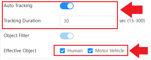

Step 3: Make sure the Auto Tracking option is enabled if using auto tracking, and set the tracking duration if needed, this will be the amount of time the object will be tracked before the operation is complete if the object is not out of frame. By default, the camera will detect both human and vehicles, however it can be set to detect only human or vehicles if needed by disabling an object filter. Click Apply.

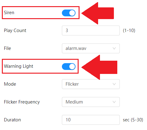

Step 4:  To set deterrents, enable the Siren and Warning Light option to enable active deterrents.
Siren: This checkbox allows the camera to activate the alarm once an event is detected.
Play Count: The amount of time the siren will sound.
Warning Light: This checkbox allows the camera to activate the red/blue LEDs once an event is detected.
Mode: The current mode of the warning light LEDs will be set to flicker only.
Flicker Frequency: The intensity of the warning light LEDs after they are activated. Can be set to high, medium, or low depending on the user’s preference.
Duration: The amount of time the warning LED will flash.
