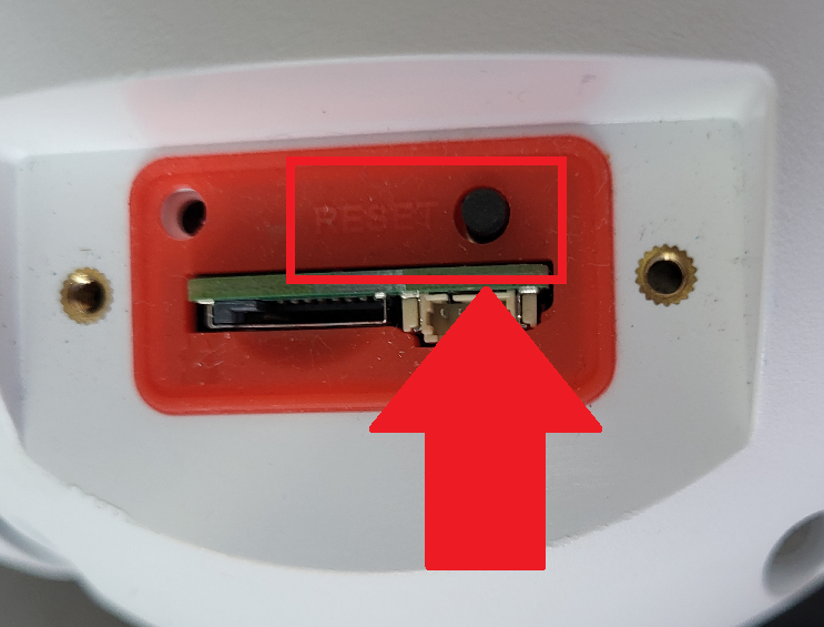

Step 1: Remove the hatch located on the back of the device.
Step 2: Locate the reset button, press and hold the reset button for 30-45 seconds and allow the camera to factory reset.
Step 3: Once the reset is complete place the hatch back onto the camera and secure it to the camera. The camera has now been factory reset and reverted to its original factory settings. This includes usernames, passwords, and other settings. The default username and password will always be admin.
