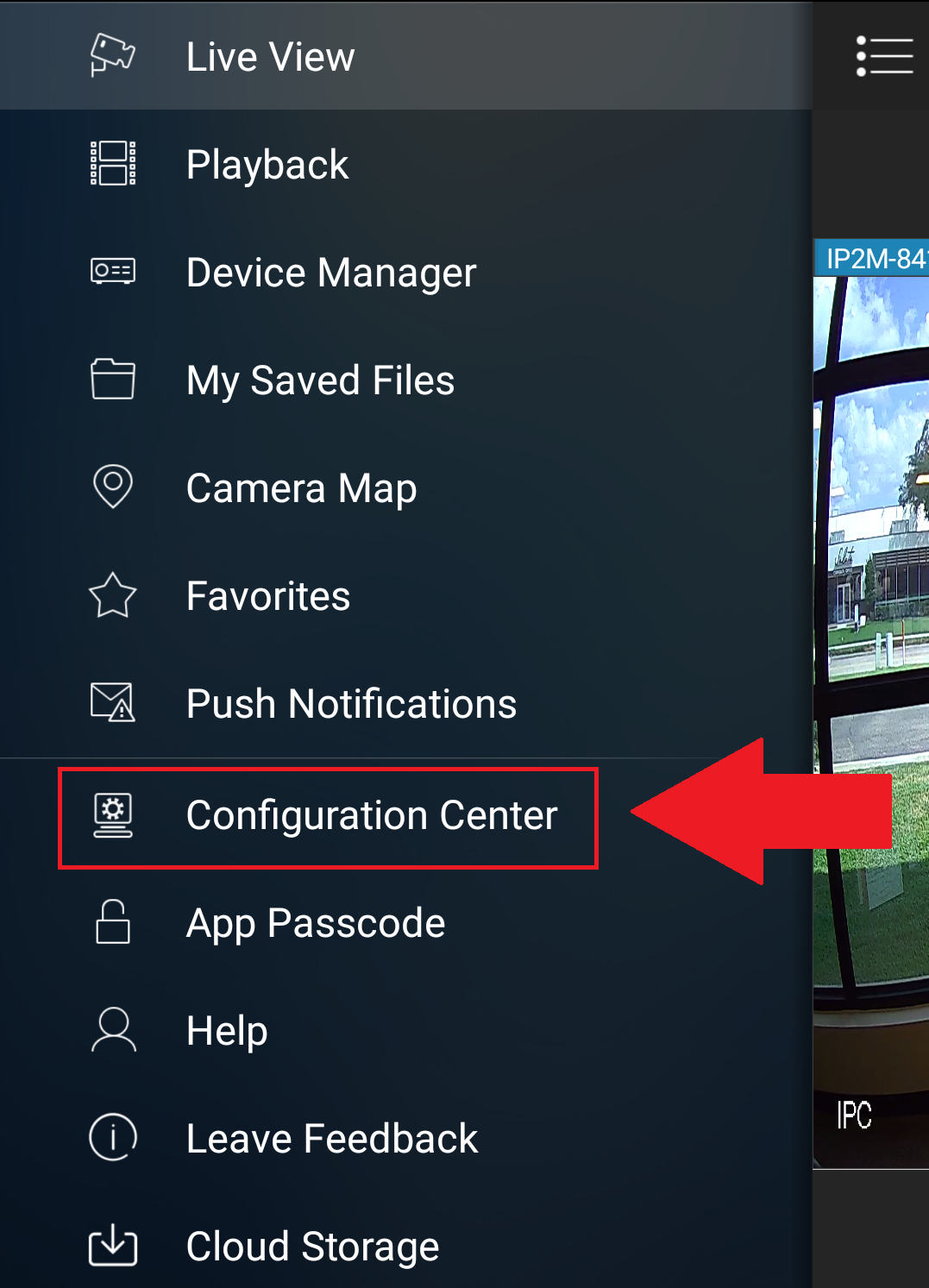

Step 2: Tap on the main menu ( mceclip0.png ) located in the upper left-hand corner and tap on Configuration Center.

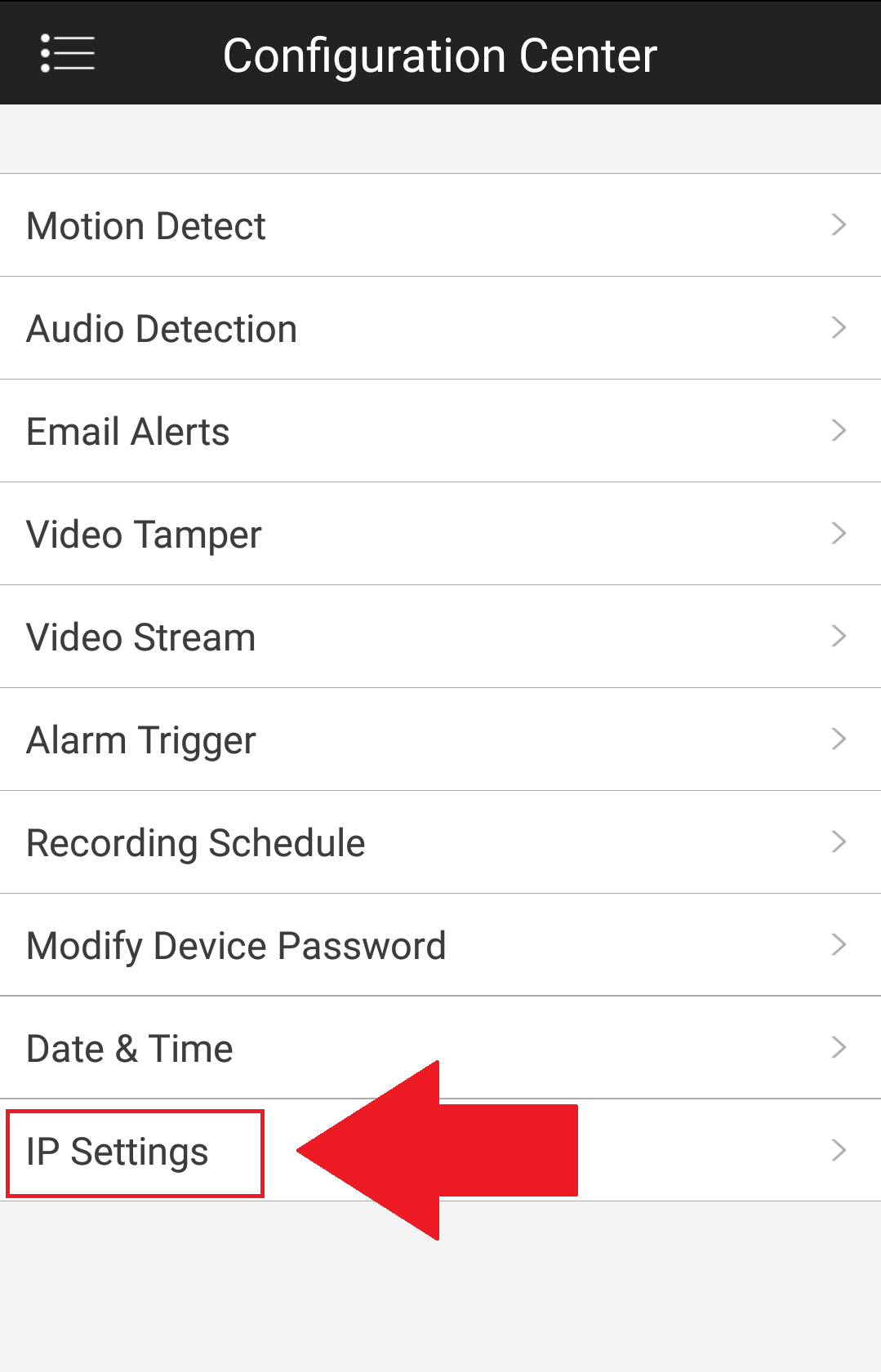

Step 3: From the Configuration Center menu, tap on IP Settings.

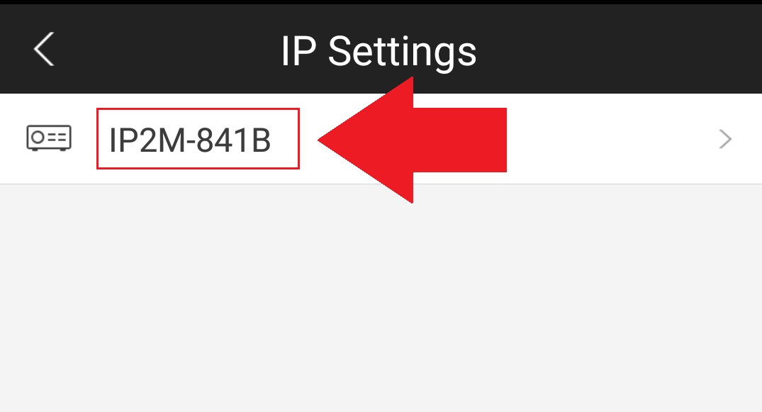

Step 4: Select your device from the IP Settings menu

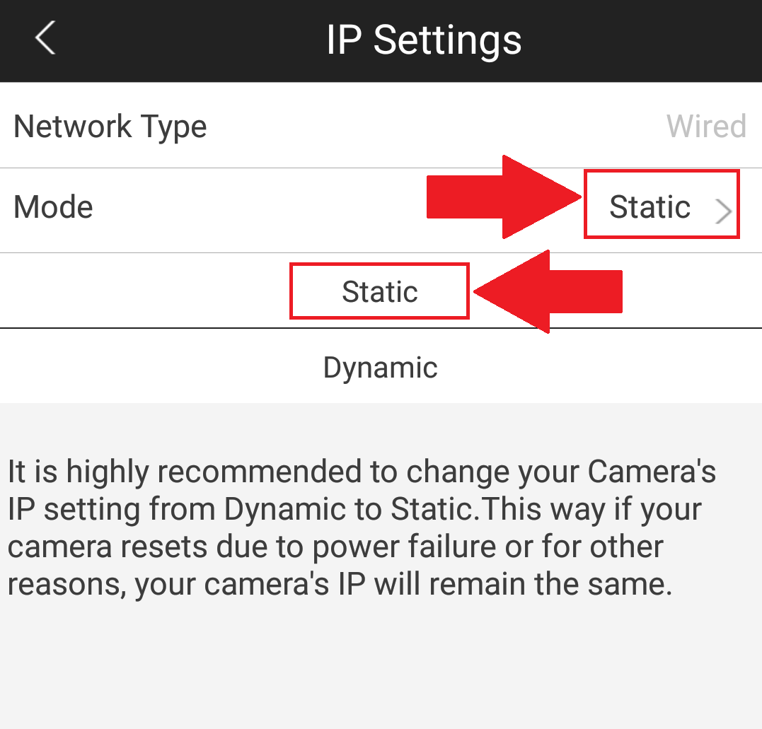

Step 5: Tap on the Mode option to display the dropdown menu. tap on Static to set the device to a static IP address.

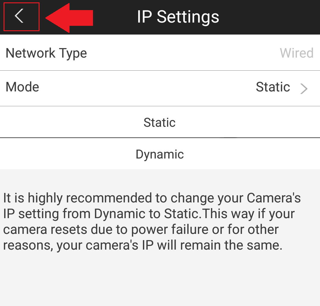

Step 6: The IP setting will be saved once a selection has been made. Tap on the back arrow (mceclip1.png) to exit the IP Settings menu.
