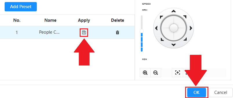

Step 2: Access the AI menu and click Please add a preset first.
Step 3: Click Add Preset and set a preset for the rule if needed using the provided PTZ options. Double click the Name field and enter a name for the preset. Click Apply, then click OK.

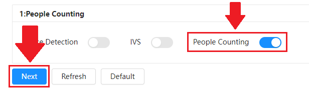

Step 4: Click +Preset and add the smart plan to the interface. Select the People Counting smart plan and click Next.

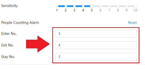

Step 7: Enter the people counting alarm thresholds, this will determine the number of people entering, exiting, or standing in the detection area before the people counting rule is triggered.
Note: To set the OSD information on the people counting overlay back to zero, click Reset.
