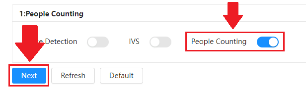

Step 4: Click +Preset and add the smart plan to the interface. Select the People Counting smart plan and click Next.

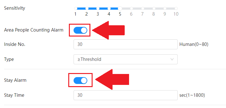

Step 6: Use your mouse to draw a detection area on the interface. Enable the Area People Counting Alarm option and set the inside number parameters, the default number is 30, however, this can range between 0 – 80. Select a threshold from the Type dropdown menu, this will tell the camera to trigger the alarm if the threshold of people inside the detection area is greater than, less than, equal to, etc. the inside number.
A stay alarm can also be configured which will allow the camera to trigger the rule if a person is inside the detection area for a specified amount of time, this can range from 1 to 1800 seconds if needed.
