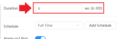

By default the rule will be set to trigger if an object is within the detection area for a duration of 6 seconds. However, you can adjust the duration if needed from 6 - 300 seconds.
Screenshot 2024-02-08 125744.png.
