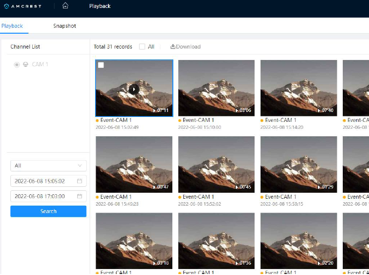

To view a recording, click on the “All” dropdown menu and select which record type you would like to view. There are several event record types that can be selected including a general record type, which will display all continuous recording events, an Event record type which will display all motion detection and other motion activated recordings, as well as an alarm (external alarm) and manual record types.
Select a record type from this menu and click on the start time option. A calendar will appear, choose a start date of the recording you would like to view then click “Select time”. The default start time will be set to 00:00:00, which is midnight, use the scroll-down options to select the exact hour, minute, and even seconds of the start of the event. In this example, we are using 15:05:02, which is 3:05 pm. Click Ok to set the start time.
Next, click on the end time option. A calendar will appear, choose an end date of the recording you would like to view and click “select time”. The default end time will be set to 23:59:59 which is roughly 1 second before midnight. Use the scroll down options to select the exact hour, minute, and even seconds for the end of the event. In this example, we are using 17:03 which is 5:03pm. Click Ok to set the end time.
Click Search. The interface will display the total number of events within the specified time frame.
To view the event, hover your mouse over the selected event and click the play button. The list of events will be displayed in the left panel and the selected recording will start to play in the interface.
