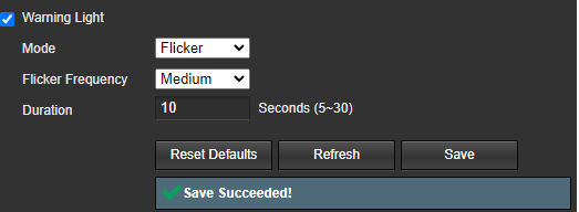

Step 3: In the setup menu, enable the warning light option. This will allow the camera to activate the warning light once an event is detected. Click Save.
Warning Light: This checkbox allows the camera to activate the white light LEDs once an event is detected.
Mode: The current mode of the warning light LEDs will be set to flicker only.
Flicker Frequency: The intensity of the warning light LEDs after they are activated. Can be set to high, medium, or low depending on the user’s preference.
Duration: The amount of time the warning LED will flash.

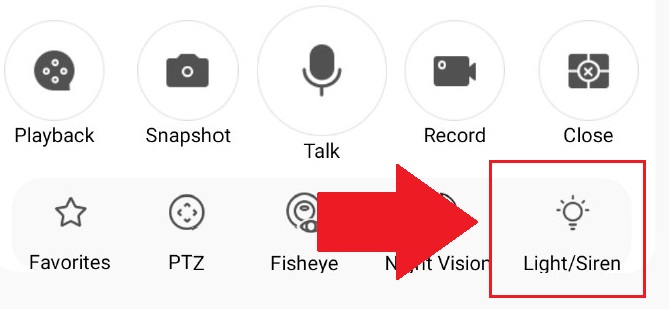

How To Enable or Disable Using Amcrest View Pro 2
The warning light can also be manually enabled or disabled using the Amcrest View Pro 2 app on your mobile device. To enable the white light LEDs on your device, click the LED option in the app and use the provided options.
