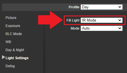

Step 2: Navigate to Setup>>Configuration>>Light Settings and select the Fill Light drop down menu.
Step 3: By default, the camera will be set to IR Mode. Select a different night vision setting, such as white Light mode, or smart illumination. Smart illumination will have the IR LEDs illuminate at night, however, will illuminate the white light LEDs once a motion even is detected.
Step 4: Click Save to apply the new night vision settings to the camera.
Note: To disable night vision completely, access the Mode menu and select OFF. Click Save to save and apply the settings .
