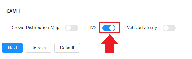

Step 2: Access the main menu and click on AI, select IVS, and click Next.

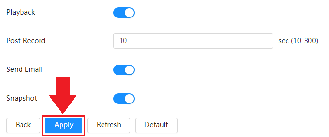

Step 4: Click Playback to retain events to a microSD card. This will allow you to view IVS events in the playback menu. Select any additional options, such as Send Email to send an notification of the event to an entered email address. For more information on how to setup email alerts, click here. Click Apply when finished.
