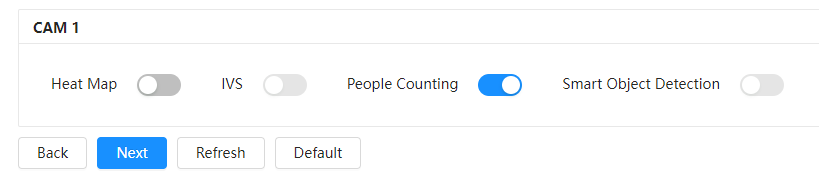

Step 3: Click Next. Select People Counting from the Smart Plan menu and click Next.
Note: A heat map rule can be setup with people counting if needed, for more information about heat map, click here.

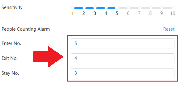

Step 4: A people counting rule will be selected by default. Enter the people counting alarm thresholds, this will determine the number of people entering, exiting, or standing in the detection area before the people counting rule is triggered.
Note: To set the OSD information on the people counting overlay back to zero, click Reset.
