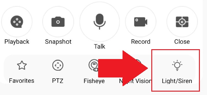

How To Enable or Disable Using Amcrest View Pro 2
The warning light can also be manually enabled or disabled using the Amcrest View Pro 2 app on your mobile device. To enable the white light LEDs on your device, click the LED option in the app and use the provided options.
