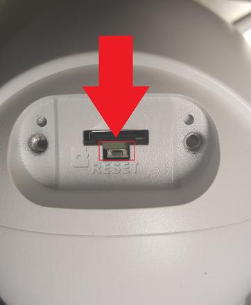

Step 1: Locate the Reset hatch on the top of the camera. Using a Phillips head screwdriver, remove the 2 security screws to open the hatch.
Step 2: Press and hold the Reset button for30 - 45 secondsallowing the camera to reset.
Step 3:Once the reset of the camera is complete, place the reset hatch back onto the camera and secure it to the camera using a Phillips head screwdriver and security screws.
