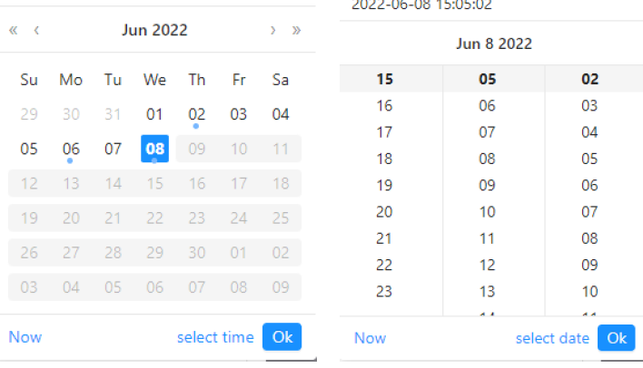

Select a record type from this menu and click on the start time option. A calendar will appear, choose a start date of the recording you would like to view then click “Select time”. The default start time will be set to 00:00:00, which is midnight, use the scroll-down options to select the exact hour, minute, and even seconds of the start of the event. In this example, we are using 15:05:02, which is 3:05 pm. Click Ok to set the start time.

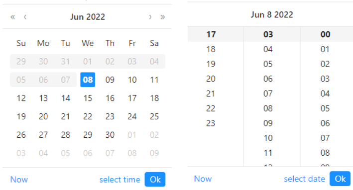

Next, click on the end time option. A calendar will appear, choose an end date of the recording you would like to view and click “select time”. The default end time will be set to 23:59:59 which is roughly 1 second before midnight. Use the scroll down options to select the exact hour, minute, and even seconds for the end of the event. In this example, we are using 17:03 which is 5:03pm. Click Ok to set the end time.

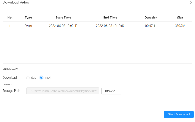

Events can be downloaded directly from the playback interface to your computer. These recordings can be saved in .dav or .mp4 format. The interface allows you to download a single event or multiple events if needed, if you would like to download all events, click on the “All” option located next to the total records field.
To download a recording, select an event ensuring it has a blue checkmark next to the event. After selecting the event, click the Download button to launch the download interface.
The download interface will display the total number of events being downloaded, the event type, the start & end times, the duration of the event as well as the total size (MB) of the event. Please note, the default format of the event will be .dav however, this can be changed to .mp4 by selecting .mp4. Click on Browse to select a download path for the events and click Start Download to download the selected events to your computer.
