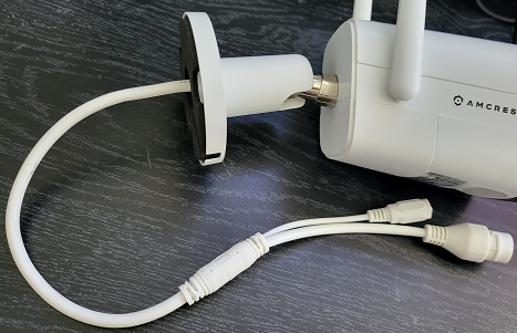

The camera comes equipped with a power port connection, which requires a 12V, 2.0A power adapter and an Ethernet port which can be used as a secondary means of adding the camera to your Wi-Fi network using an Ethernet cable. These connections are located on the dongle wire connection found on the back camera. Please note, Ethernet WIFI should be used as a secondary means of adding the camera to your network if the Wi-Fi method is unavailable.  For more information on how to to connect the camera to your network using an Ethernet cable click here.
Note: This is not a PoE camera and will require a 12V, 2.0A power adapter to function. For best performance, please make sure your camera is up to date on the latest firmware. To access the latest firmware, please visit amcrest.com/firmware.
