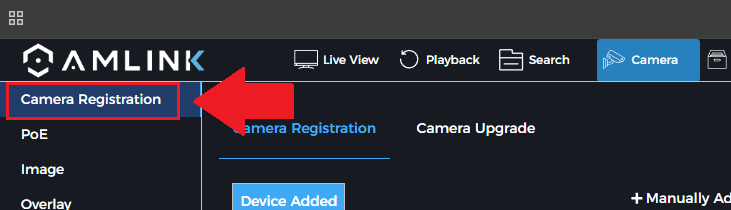

Step 2: Click on Camera and access the Camera Registration menu.

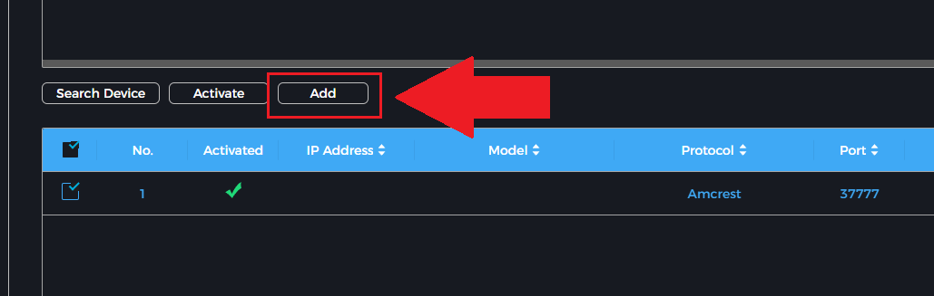

Step 3: Click Search Device, select your devices from the device list and click Add. The NVR will add the camera using the Amcrest protocol.

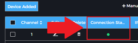

Step 4: In the Edit menu, enter the password for your camera and click OK. Verify the connection status, the status should be green indicating the device is successfully connected to the AMLINK NVR. If it is red, please make sure to verify the camera's password in the modify menu.
