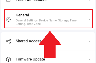

Step 1: Open the AMLINK Pro app and access your device. Tap the device settings icon (•••) and select General.

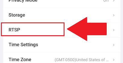

Step 2: You will notice multiple settings options for your camera. Tap RTSP.

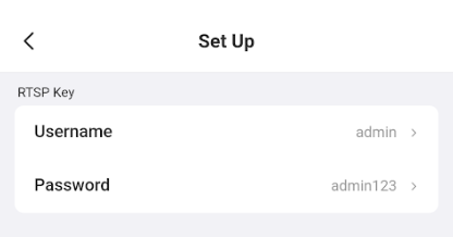

Step 3: Review the RTSP prompt and tap Next. The RTSP key menu will be displayed. This menu allows you to set a custom username and password for your RTSP stream, however, it can be left as default if needed. Tap Confirm when ready.
Note: Enabling RTSP will disable cloud storage and stop cloud events. If you are ok with this tap Yes to activate RTSP.

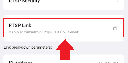

Step 4: The RTSP link will be displayed in the interface. The RTSP link can be entered manually into the NVR or you can copy it and sent it to yourself so you can paste it into the web user interface of the NVR.

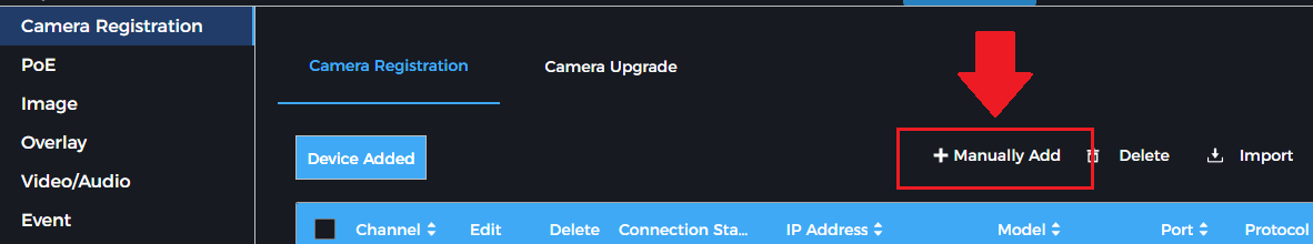

Step 2: Select Camera and click "+Manually Add".

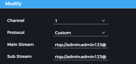

Step 3: In the Protocol menu, select the Custom protocol then copy or enter the RTSP link into the Main Stream field. Once the RTSP link is entered, click OK to finish adding the device into the NVR.

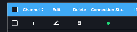

Note: If the status is red, select the device you just added and click refresh, the status will turn green indicating it is added properly into the NVR.
