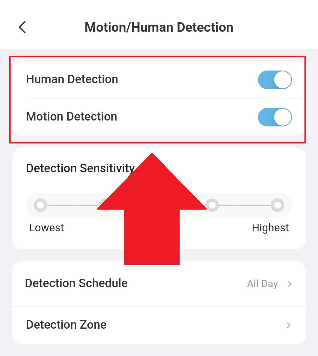

Step 2: Tap Detection Settings.
Step 3: Use the Human Detection and Motion Detection options to enable or disable these options. Enabling motion detection and human detection together will allow both human and basic motion detection events to be detected by the camera.
The detection sensitivity options can be set to high, middle, or low if needed. The lowest setting will have the least amount of objects detected, while the highest sensitivity will have more events. It is highly recommended to keep sensitivity as default (middle) for best results. The AI tracking feature can also be enabled to allow the camera to track an object once it is detected by the camera until the object is out of frame,
Step 4: Set any motion detection schedules if needed. By default, the camera will be set to detect objects continuously (24/7) however a detection schedule can be created within the app to allow the camera to only detect human/motion detection events during a specific day and time.
Step 5: Set and customize any detection zones using the Detection Zone menu. The detection zone menu allows you to set and customize a detection zone for human and motion detection.
Step 6: The motion warning menu allows you to set a warning message or greeting to trigger once a motion is detected.
