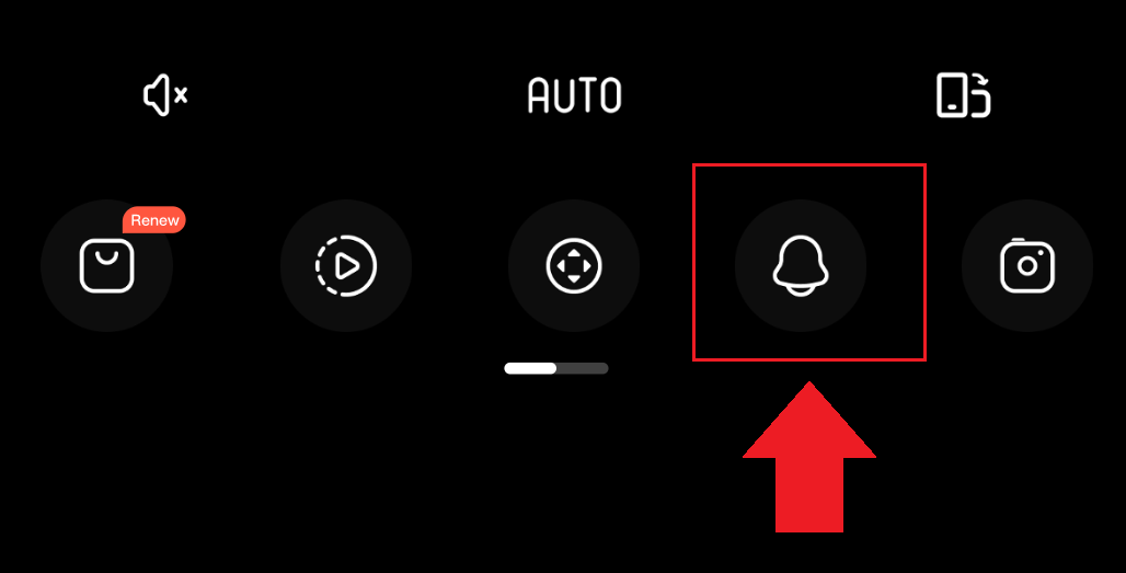

The Message menu allows you to view and display device specific events in a list, this includes motion detection and human detection events stored on a microSD card or stored in the cloud. To access this menu, open the AMLINK Pro app, access your device from the home menu, and select the bell icon on the bottom banner.
A list of events captured by the camera will be displayed, use the microSD card icon to access events from a microSD card, tap the cloud icon to access events stored on the cloud.

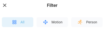

To view an event, select the event you would like to view and tap on the event. The app can also filter to only display motion or human detection events. Tap the filter icon and select a filter to display only those events for the day.
