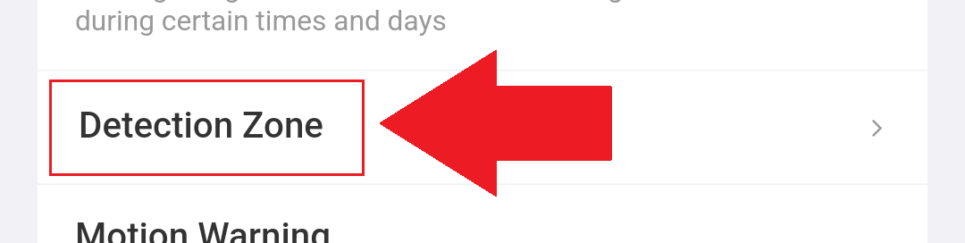

Step 2: Open the Motion/Human Detection menu and tap Detection Zone.

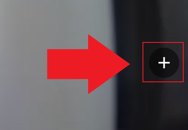

Step 3: Tap Draw Detection Zone and tap the "+" icon to add a detection zone.
Step 4: Use your finger on the provided overlay to modify the detection zone. Tap the checkmark to set the detection zone.
