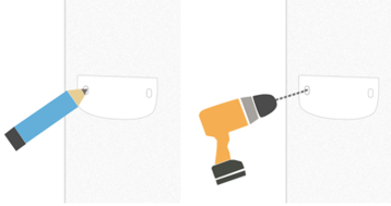

Step 1: Apply the installation template to the mounting surface and drill the holes.

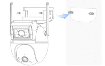

Step 2:Insert the included wall anchors and align the holes of the camera base. Use a Phillips head screwdriver to hand tighten the camera base to the mounting surface to secure the camera.
