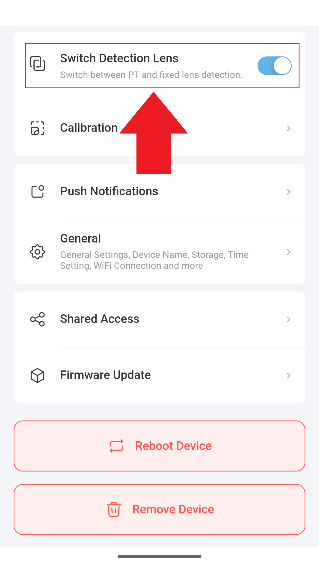

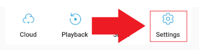

Step 1: Open the AMLINK Pro app and access the settings for your device.
Step 2: Scroll down and tap Switch Detection Lens.
This will switch the camera to fixed lens detection, disable this feature again if you would like to switch back to PT lens detection. If using AI tracking for human detection, please make sure the detection lens is set to PT. For more information on AI tracking, click here.
