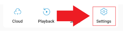

Step 1: Open the AMLINK Pro app and access the settings for your device.

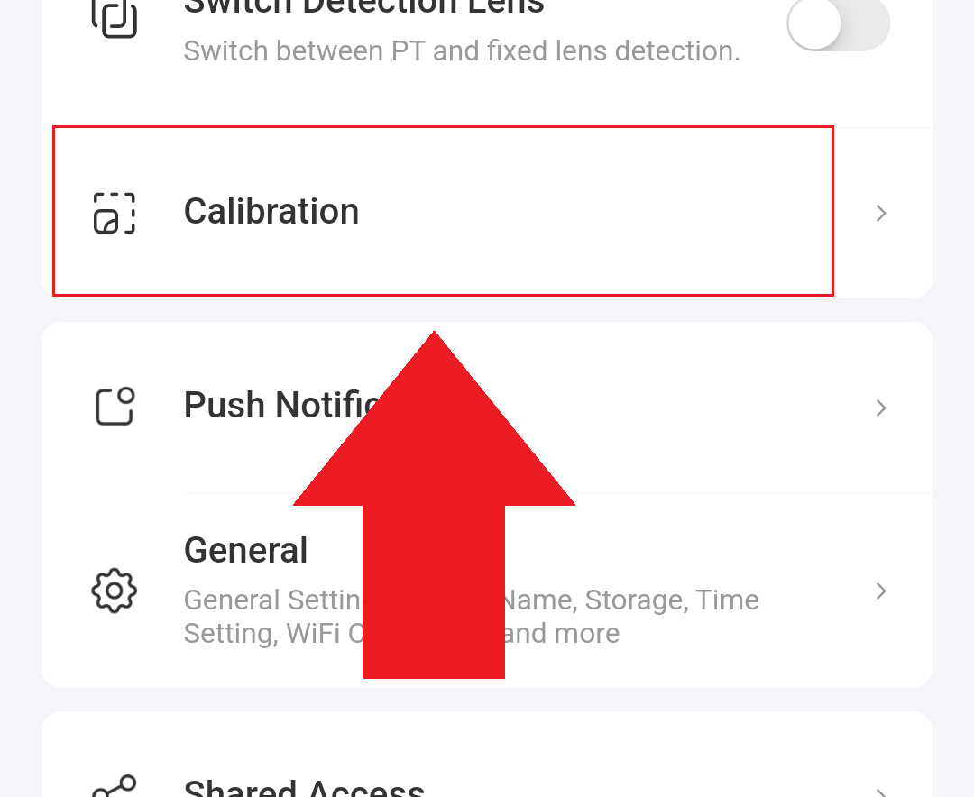

Step 2: Scroll down and tap Calibration.

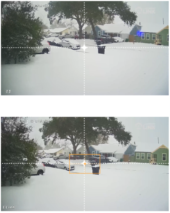

Step 3: Make sure the center points of the fixed lens camera and PT lens camera are aligned. If not, use your finger on the yellow overlay to make sure the fixed lens and PT lens views are consistent.
Step 4: Once the center points PT lens camera is aligned with the fixed lens camera view, tap Confirm to complete the calibration process.
