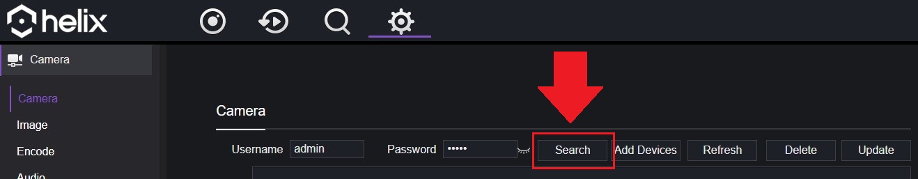

Step 2: Click on the Settings icon (gear wheel) and select Camera. Click Search.

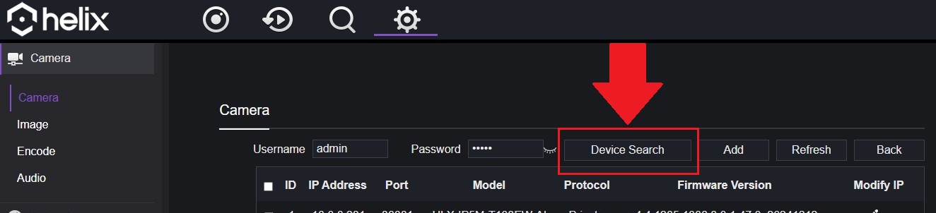

Step 3: Click Device Search.

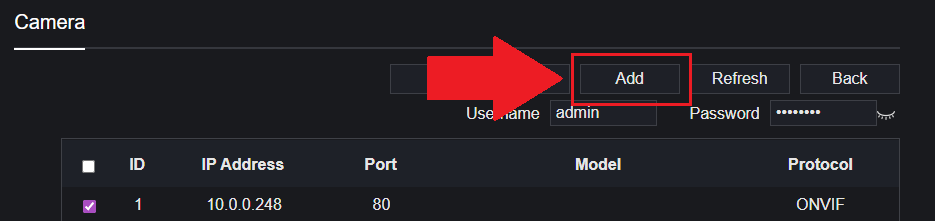

Step 4: Select your devices from the device list. The device will have a default ONVIF protocol in the interface, click Add. After it has been added, click Back to exit the menu.
