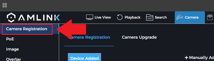

Step 2: Click on Camera and access the Camera Registration menu.

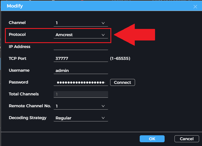

Step 3: Click Search Device, select your devices from the device list and click Add. The device may default to ONVIF. To use the Amcrest protocol to add your camera, click the Edit icon. In the Modify menu, select Amcrest in the Protocol field. Enter the password for your camera and click OK.
Step 4: Verify the connection status. The status should be green indicating the device is successfully connected to the NVR. If it is red, please make sure to verify the camera's password in the modify menu.
