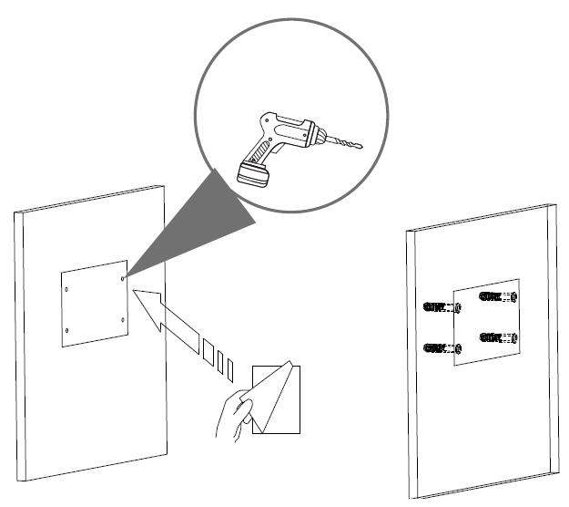

Step 1: Peel the sticker of the installation sticker off and place it onto the mounting surface. Use a drill to drill the installation holes and insert the included wall anchors into the holes.

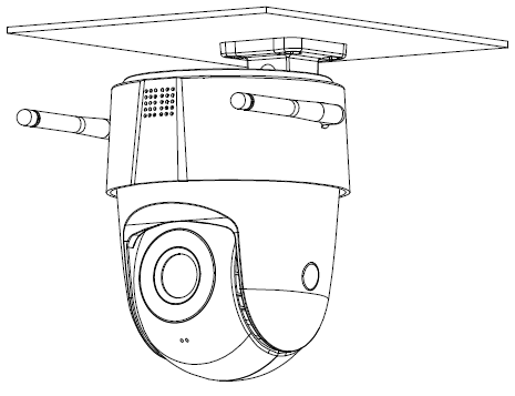

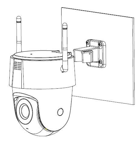

Note: If you are installing on a wall, make sure the arrow on the installation sticker is pointing upwards. A 1" diameter hole can be drilled if running wiring through a wall. If you are installing it on a ceiling, make sure the arrow on the installation sticker is pointing downwards.

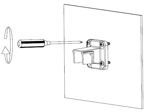

Step 2: Align the holes on the installation bracket with the wall anchors. Insert the installation screws into the holes and use a Phillips head screwdriver to secure the installation bracket to the mounting surface.

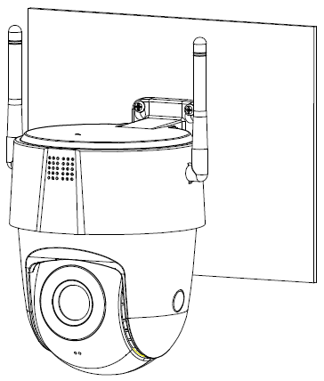

Step 3: Insert the camera into the bracket and align the security holes of the camera to the security holes on the installation bracket.

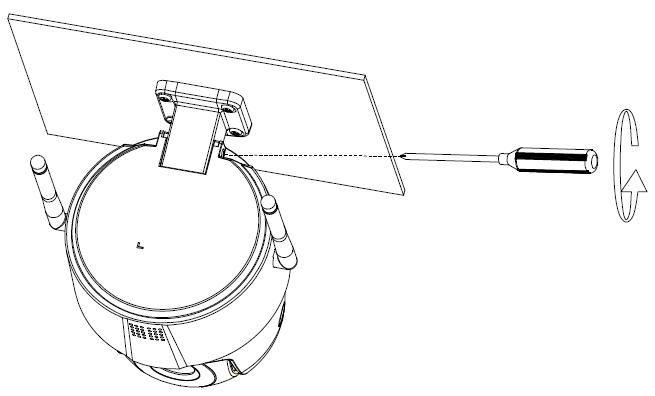

Step 4: Insert the included security screws into the security holes and use a Phillips head screwdriver to tighten these screws to secure the camera to the installation bracket.
Note: If you are installing on a wall the Wi-FI antennas can be facing upwards, however, if you are installing on a surface such as a ceiling, the antennas can be facing forwards.
