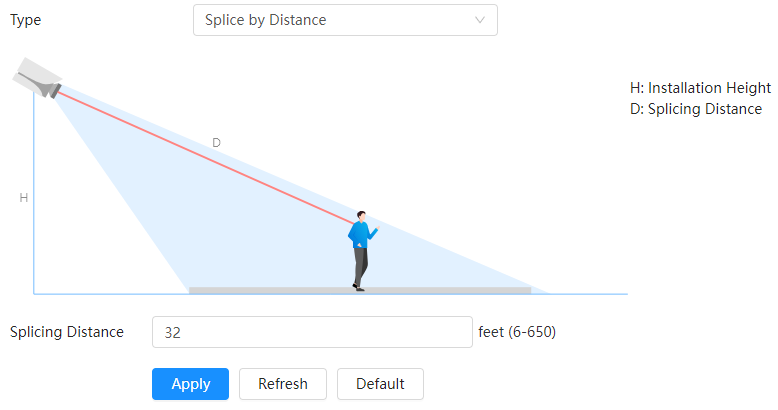

How Does Camera Splicing Work (IP8M-DLB2998W-AI)
The splicing menu allows the user to calibrate the camera based on the height and total distance of the detection area. It will take images from each lens and splice them into once panoramic view.
To use this feature, enter the splicing distance from the height of the camera (6-650ft) and click Apply, the camera will begin to splice the image automatically. Once calibrated, the panoramic view spliced will be displayed in the interface.
