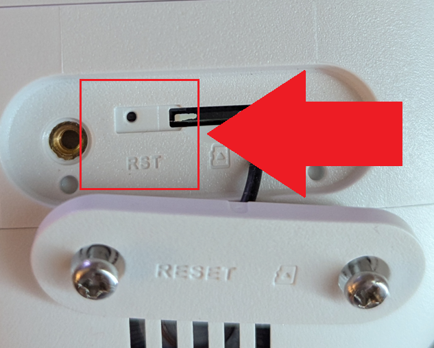

Step 1: Locate the reset hatch on the camera and remove the cover.
Step 2: Insert a pin or similar object in the RST hole to press the reset button. Hold for 30 - 45 seconds allowing the camera to reset.
Step 3: Once the reset of the camera is complete, place the reset hatch back  and secure it to the camera.
The camera has now been factory reset and reverted back to its original factory settings. This includes usernames, passwords and other settings. The default username and password is admin.
