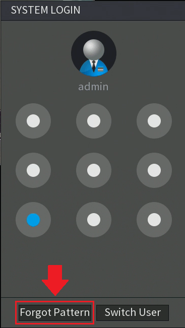

Typically, an unlock pattern is the default means of accessing your DVR. If you have forgotten or need to reset the unlock pattern for your device click on the Forgot Pattern button.

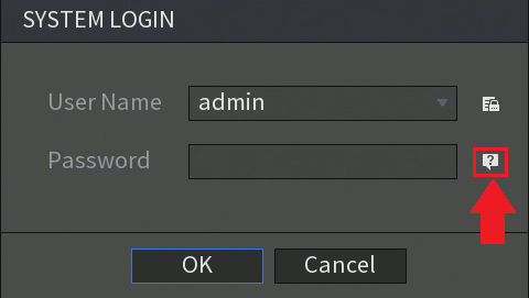

Next, in the system login screen, click on the Forgot Password icon (My_Great_Capture_Screenshot_2018-09-19_10-41-06.png) to access the Reset Password menu.

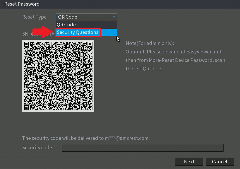

There are two ways to reset your password, you can use the QR code method, or via assigned security questions that were set by you during initial setup. We will begin with the QR code method first.
QR Code Method
Scan the QR code provided using any QR code scanning app on your mobile device.

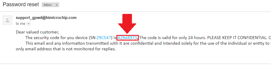

Once you have successfully scanned the QR code email the entire code provided in the app to support_gpwd@htmicrochip.com. A reply from this email will be sent from this sender.
Open the email and locate the generated security code that was sent to you. This will be the security code you will need to type into the DVR to reset your password.
Note: The security code that was provided will only be valid for 24 HOURS. If you do not use the code within 24 hours a new one will have to be generated to complete the password reset process.

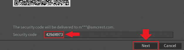

Next, enter the provided security code from your email into the Security code field in the Reset Password menu then press Next to continue.

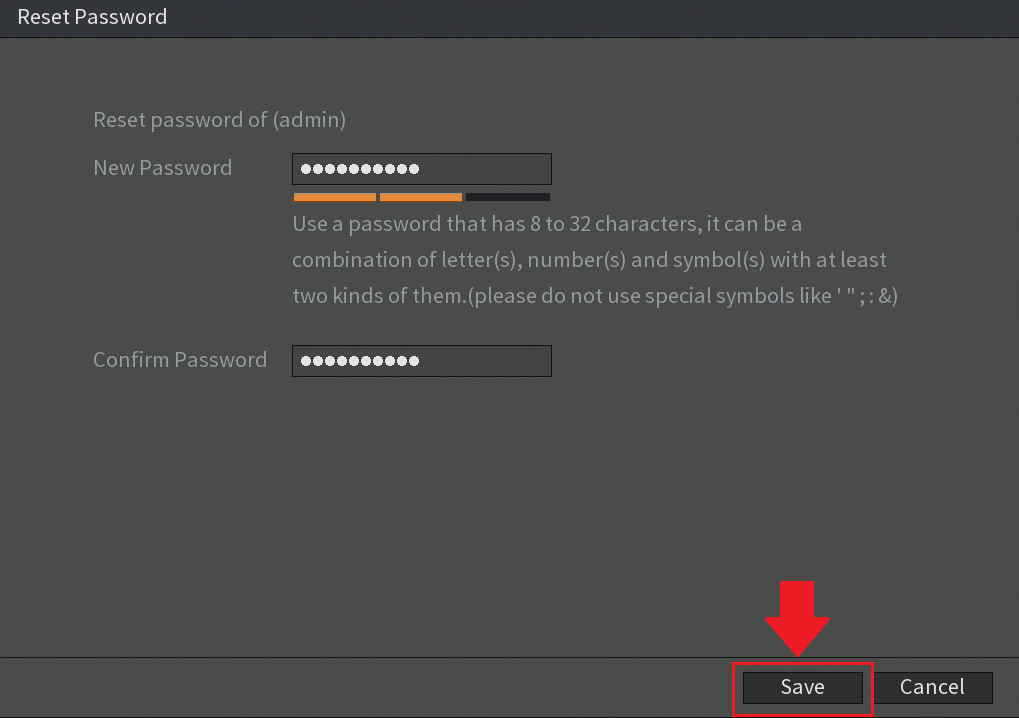

Type in the new password for your device in the New Password field and type it again into the Confirm Password field. Please note, it is recommended to use a password that has between 8 to 32 characters using a combination of letters and numbers. Please do not use special characters such as, ( ' " ; : &). When you have entered a strong enough password, click on the Save button to save the new password to your device.
Your new password is now applied to your device, click OK. You will now be able to login using your new password. Enter the new password into the System Login screen and press OK to log into your system.
Security Questions
If you do not want to use the QR Code method to reset your password you can answer the assigned security questions that were set by you during initial setup. To begin, navigate to the System Login menu and click on the Forgot Password icon (My_Great_Capture_Screenshot_2018-09-19_10-41-06.png) to access the Reset Password menu. From the Reset Type drop down menu select Security Questions.

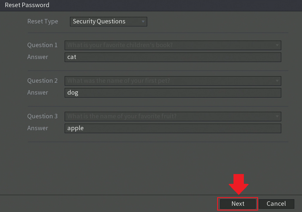

Enter the answers that you assigned for each security question and press Next to continue.
Type in the new password for your device in the New Password field and type it again into the Confirm Password field. Please note, it is recommended to use a password that has between 8 to 32 characters using a combination of letters and numbers. Please do not use special characters such as, ( ' " ; : &). When you have entered a strong enough password, click on the Save button to save your new password to your device.
