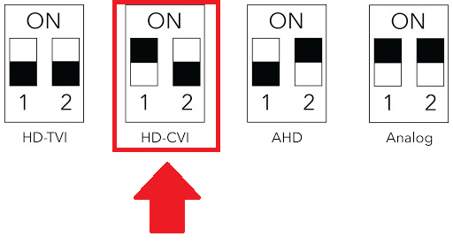

Each quadbrid camera is compatible with HD-CVI, HD-TVI, AHD, and Analog systems. The settings for these cameras can be adjusted on the mode switch which is connected to the camera as displayed in the image below:
Each mode switch setting can be configured per device. For instance, an Amcrest HD-CVI unit will have the following configuration on the mode switch:
Note: If the mode switch configuration for your camera is not properly set, you will not be able to view your cameras on your device since the mode configuration is incorrect.
Each camera is equipped with a configuration diagram which displays the different settings per device. Please ensure these settings are correct, per the specified diagram for full functionality of your camera before continuing the setup process. For more information on quadbrid cameras and their functionalities, please email us directly at support@amcrest.com or call give us a call, toll free, at 888-212-7538.
