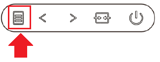

The volume on the monitor speakers can be adjusted locally using the function buttons provided on the bottom of the monitor. For more information on how to adjust the volume, please refer to the information provided below.
Step 1: Press the Menu/Enter button on the bottom of the monitor to access the function menu.
Step 2: Press the back arrow button " < " and press the Menu/Enter button to enter the Misc. menu.

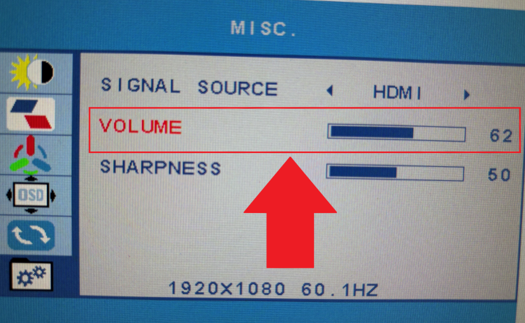

Step 3: Press the back arrow button to highlight the Volume option. Press the Menu/Enter button to begin adjusting the volume.
Step 4: Use the back and forward arrow options to adjust the volume up or down.
