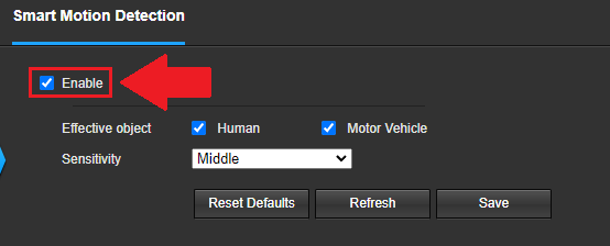

Step 2: Click on Setup>>Event>>Smart Motion Detection and click Enable.

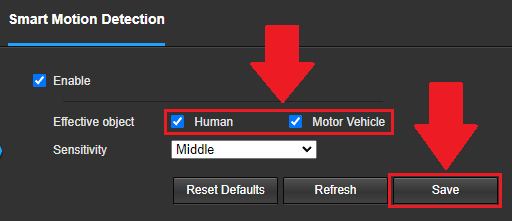

Step 3: Use the effective object filter options to allow the device to detect between human or motor vehicles. Both filters can be enabled at the same time if needed to better detect a motion event, click Save.
Note: If you would like a snapshot of the event emailed to you once it has been detected by the camera, click on the Send Email checkbox located in the Video Detection menu. Please make sure email setup is established in the camera before enabling the send email option. For more information on how to set up email notifications, click here.
