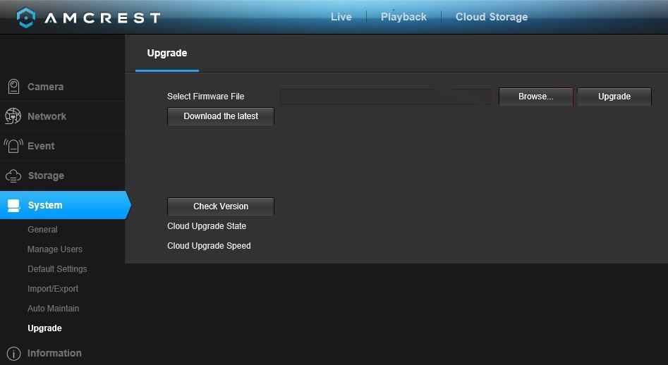

Step 2: In the web UI, please go to, Setup>>System>>Upgrade.

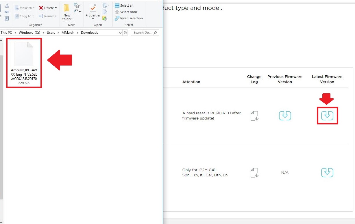

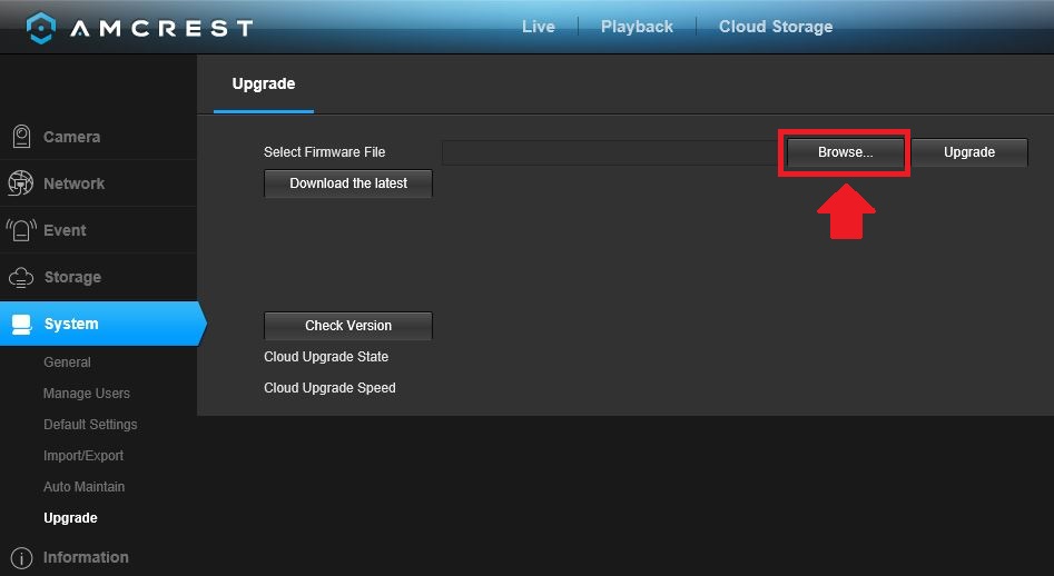

Step 3: Located the file (.bin) you just downloaded from the firmware downloads page. You can search for the file by pressing the "Browse" button.
The file (.bin) will be downloaded to the designated folder path set by the user.

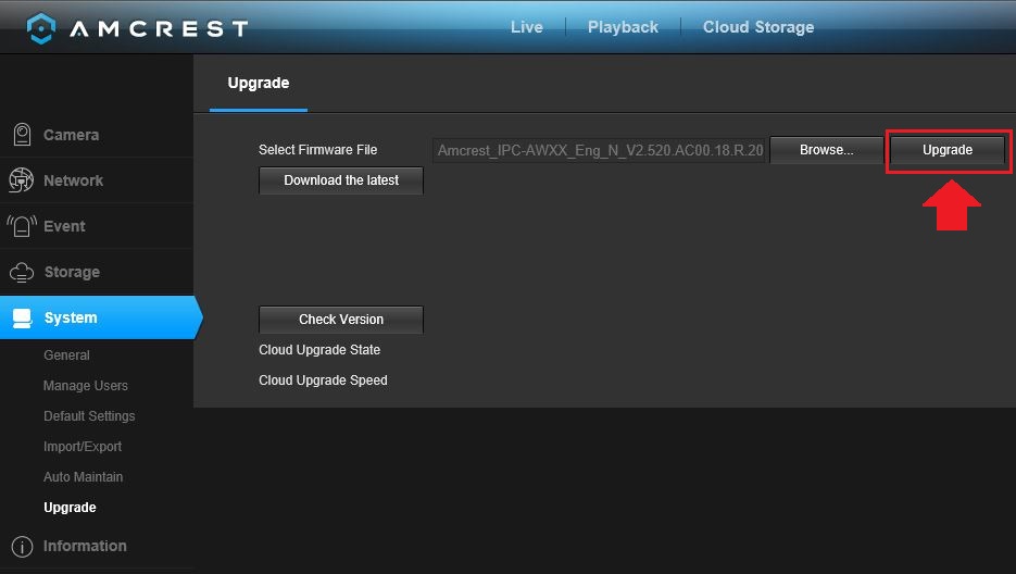

Step 4: Once your firmware has been loaded into the web UI, press "Upgrade" to start the upgrade process.

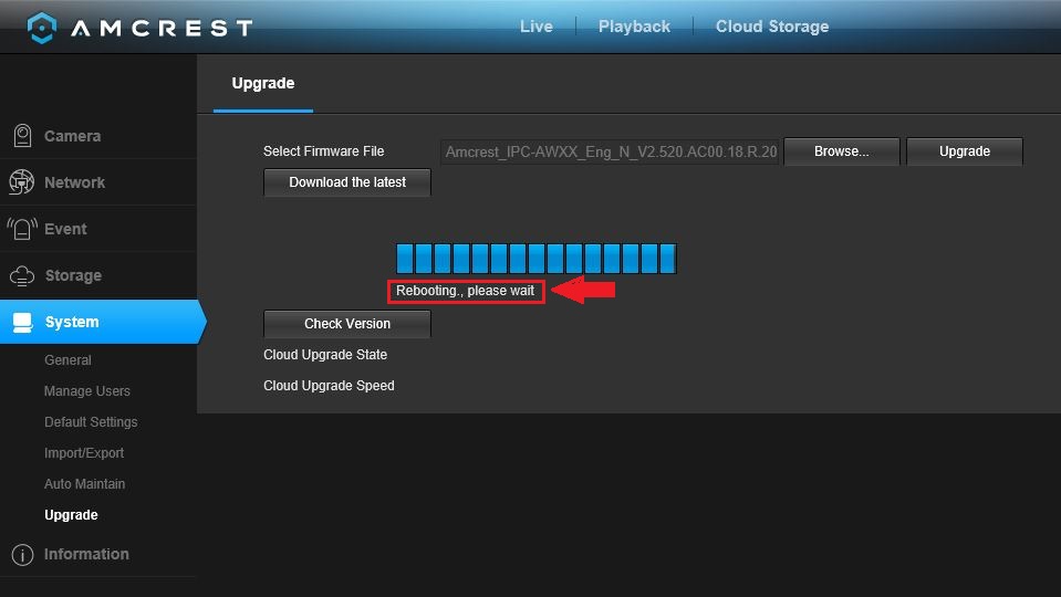

Note: Once the firmware process is complete your device will being to automatically reboot.

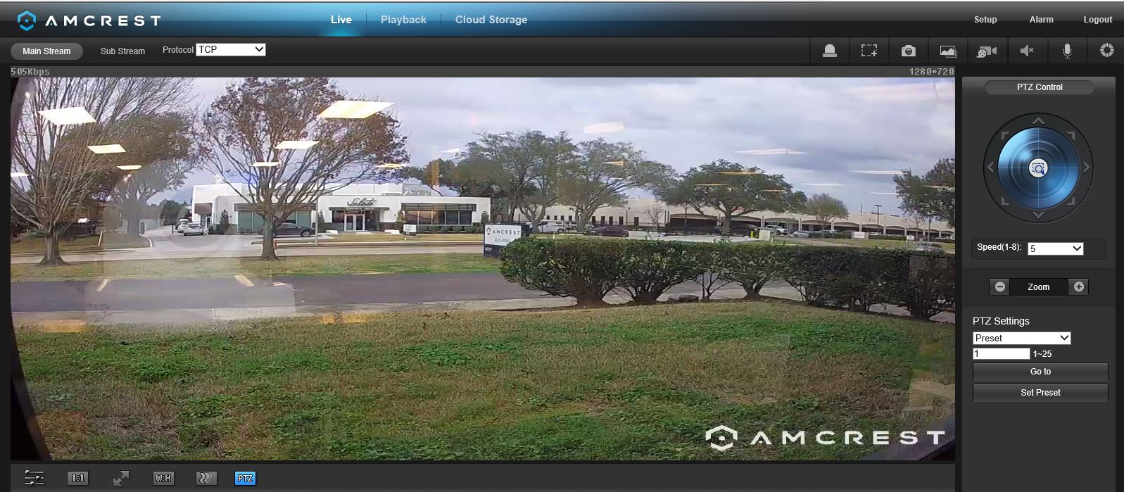

The reboot process duration varies from camera to camera, however, once your camera is back online you can access the camera's web UI.
