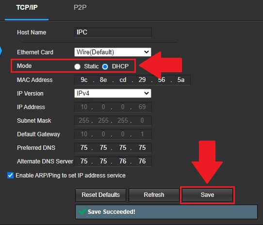

Step 1:If the camera is set to a static IP, please make sure to set it to DHCP. This will ensure the camera catches a new IP after the ISP has changed. To set the network mode of your device to DHCP, log into your camera's web UI using a browser, for more information on accessing the web browser, click here.
Inside the web browser, navigate to Setup>>Network>>TCP/IP and set the mode to DHCP. Click Save.
After the ISP has been changed and a new IP will assigned to your device, you can then set the mode back to static. This will prevent the IP address from constantly changing and disconnecting the camera due to a new IP address.
