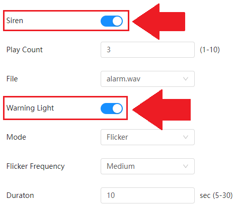

Step 4:  To set deterrents, enable the Siren and Warning Light option to enable active deterrents.
Siren: This checkbox allows the camera to activate the alarm once an event is detected.
Play Count: The amount of time the siren will sound.
Warning Light: This checkbox allows the camera to activate the red/blue LEDs once an event is detected.
Mode: The current mode of the warning light LEDs will be set to flicker only.
Flicker Frequency: The intensity of the warning light LEDs after they are activated. Can be set to high, medium, or low depending on the user’s preference.
Duration: The amount of time the warning LED will flash.
