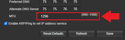

Step 2: Click on Settings>>Network>>TCP/IP.
Step 3: Locate the MTU setting and enter the desired MTU value into the interface. The recommended value is 1500 bytes however if you are experiencing network connectivity issues you may need to lower the value. It is recommended to start with 1296 bytes however you can gradually decrease these values if needed depending on the issue or specific requirements of your network. Click Save.

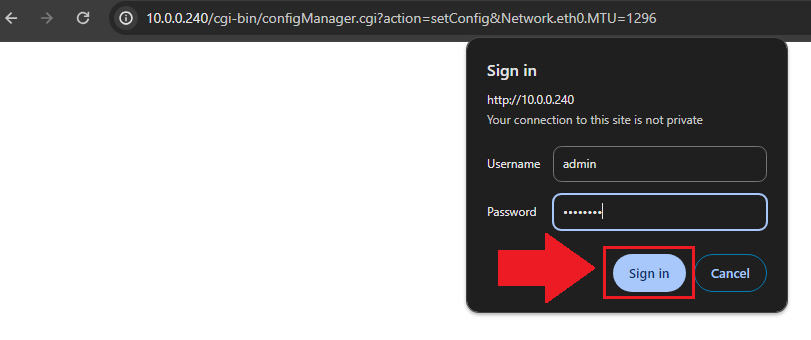

The MTU settings can also be adjusted using API commands in needed. Enter the following CGI command into the browser and log into your camera.
*CameraIP*/cgi-bin/configManager.cgi?action=setConfig&Network.eth0.MTU=**MTU VALUE**
Be sure to enter the desired MTU value into the CGI command, enter the device's login details and click SignIn.
