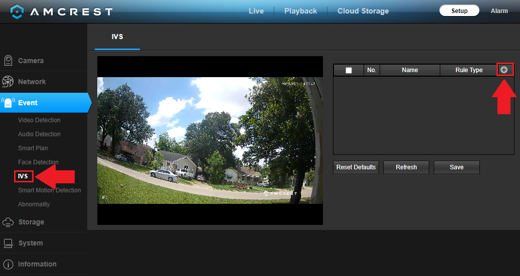

Step 3: Click on the IVS option in the Event menu then click on the ( + ) icon to add the rule.

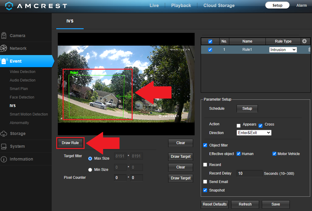

Step 4: Click on the Rule Type drop-down menu and select Intrusion. Click on Draw Rule to begin drawing the intrusion area on the interface.
This rule requires you to draw at least a four-point area on the interface to function. To draw an area, click the mouse on the interface and move it down or up to create a line. Once the line is created, move the mouse left or right to create another line and repeat the process. Right-click on the interface to set the area on the screen then left-click on the interface when done to set the area.

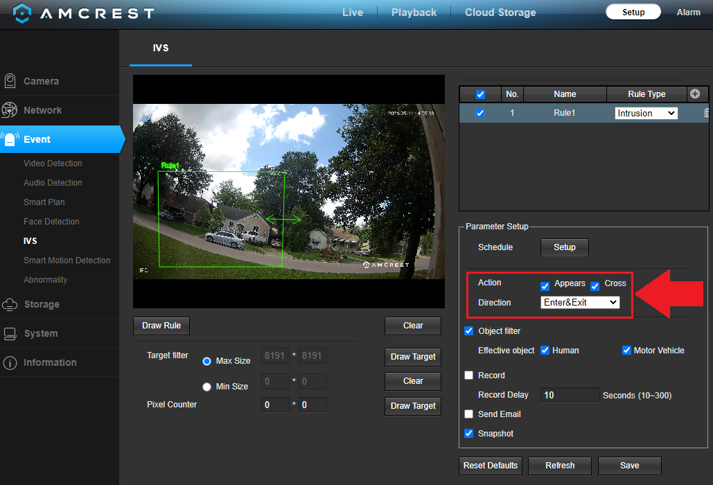

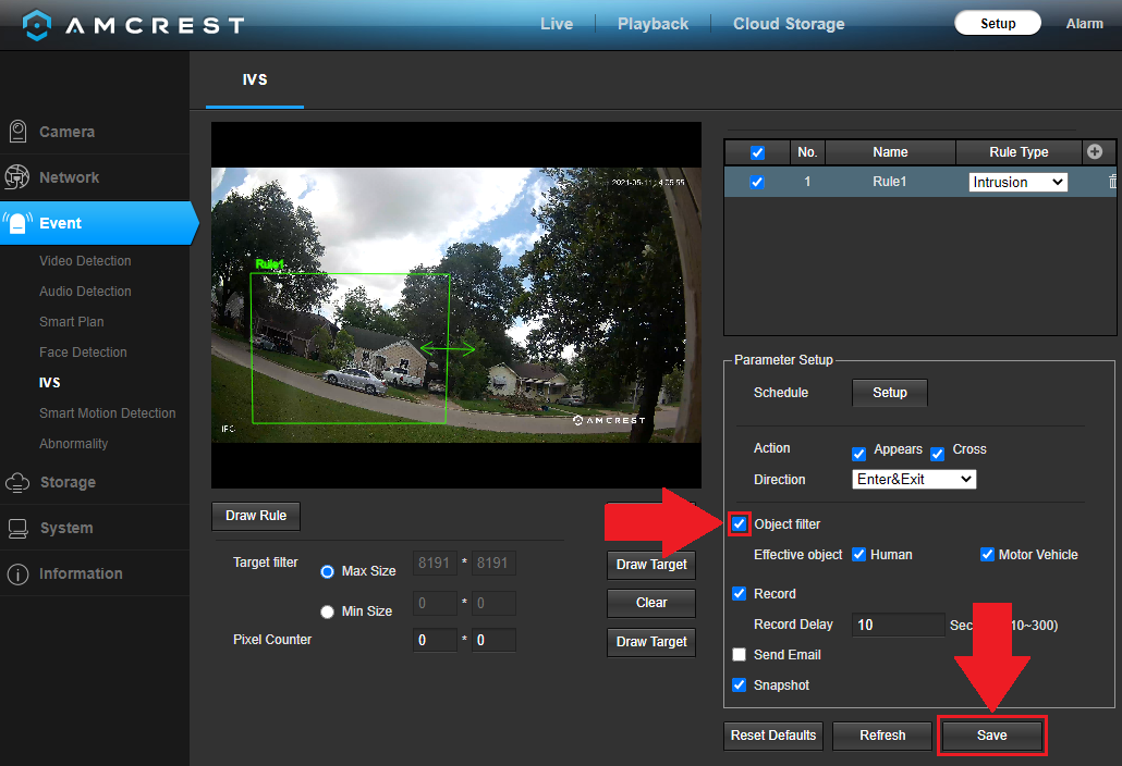

Step 5: In the Direction menu, choose how the rule will be triggered if the object enters only, exits only, or enters & exits a set region. An optional object filter can be set that will allow the rule only to be triggered if it detects an effective object such as a human or vehicle. You can choose both filters if needed.
