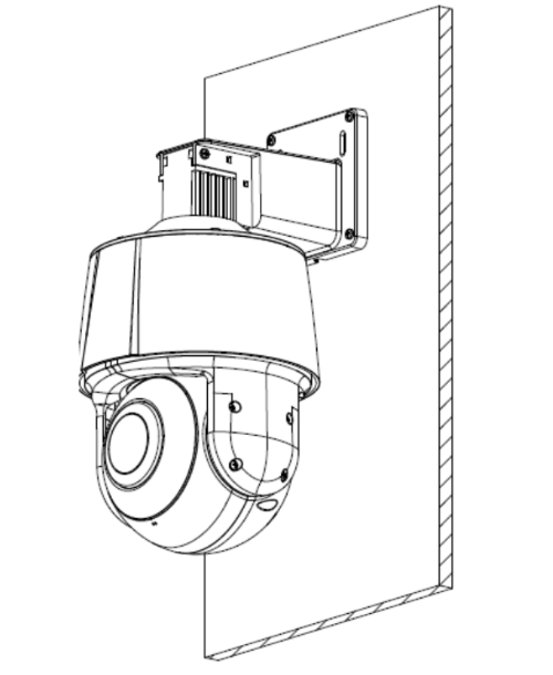

Please make sure the installation surface can support at least 3x the weight of the camera. A drill and Phillips head screwdriver may be required to physically install your camera. Please note, this is a POE device, not WiFi. This means it will provide power and data over Ethernet to the camera if applied to a POE switch, injector, etc. A power adapter is not required unless the network you are using does not support POE. For more information on how to install your device, please refer to the information provided below.
Step 1: Peel the sticker of the installation sticker off and place it onto the mounting surface. Use a drill to drill the installation holes and insert the included wall anchors into the holes.
Step 2: Align the holes in the installation bracket with the wall anchors. Insert the installation screws into the holes and use a Phillips head screwdriver to secure the installation bracket to the mounting surface.
