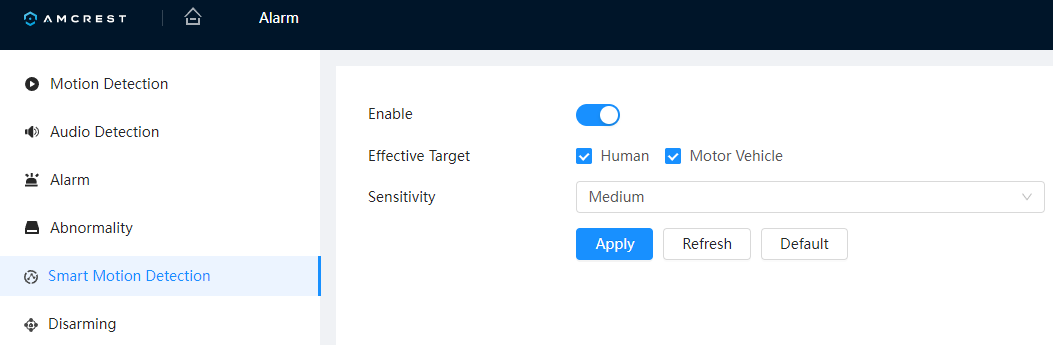

Step 2: Click Alarm from the main menu and select Smart Motion Detection. Click Enable.

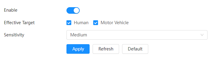

Step 3:Use the effective object filter options to allow the device to detect between human or motor vehicles. Both filters can be enabled at the same time if needed to better detect a motion event, click Apply.
