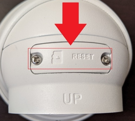

Step 1:  Locate the reset hatch on the top of the camera. Using a Phillips head screwdriver, remove the 2 screws to open the hatch.

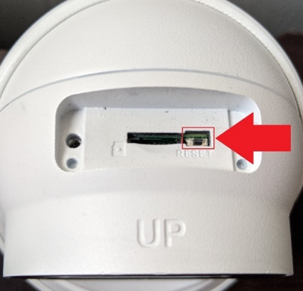

Step 2: Locate the reset button next to the MicroSD slot. Press and hold the reset button for 30-45 seconds and allow the camera to reset.
Step 3: Once the reset is complete place the reset hatch back onto the camera and secure it to the camera using a Phillips head screwdriver. The camera has now been factory reset and reverted to its original factory settings. This includes usernames, passwords, and other settings. The default username and password will be admin.
